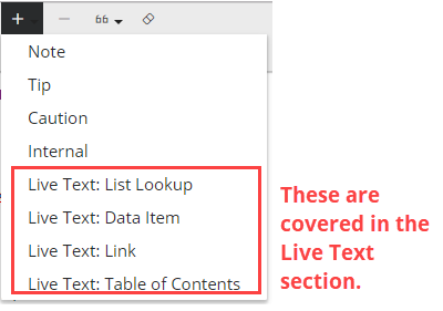

The Content field contains the content that appears in a Nextworld Help topic. This may include configuration information, details, tables, images, and so on. Do not repeat the same sentences used in the Short Description field in the Content field. The fields are separate in Content Builder, but appear as one text body in Nextworld Help.
Learn more about how to format Nextworld authored content in the Styles and custom styles topic.

Insert special text menu
Access the special text options using the Insert Special Text Add/Create menu.
Special text options are advanced formatting tools. Use special text to include formatted notes or to insert live text. Notes are described below. For more information on live text, see Live text.
Style nameUse for
NoteCreate a note to call attention to important information.
TipCreate a tip to share useful but not essential information with the reader. For example, a good tip might be an alternative way to do something described in a previous paragraph.
CautionCreate a caution to call attention to something that could be damaging or cause problems to the reader.
Artificial IntelligenceCreate an AI note to describe a feature that relies on artificial intelligence to function. These features are only available when AI is enabled in the environment.
Author CommentsCreate a note to call out temporary or internal information. These notes are hidden when the Show Comments toggle in Nextworld Help is off. Ideally, these notes should be removed before topics move from development to production.
SecurityUse security notes to provide security-related information in a topic that is not primarily about security.

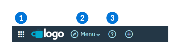

Example: main menu bar
The example below shows the format for the introductory paragraph, the diagram, and the numbered list of descriptions in a table.
The diagram below shows the different elements of the main menu bar:
1
Sidebar menu—Access pending work, saved work, and Nextworld support.
2
Navigation Menu—Search for and open applications.
3
Nextworld Help—Access Nextworld Help content.

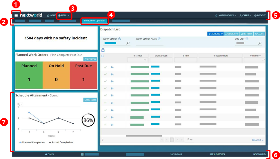

Terminology for dashboard pages
This topic identifies elements of the Nextworld dashboard and the terms that should be used to describe those elements.
ElementTermHow to useInline styleExample
1Sidebar menuCapitalize all menu names, including the Sidebar menu.
You open or close the Sidebar menu.
NoneOpen the Sidebar menu to view work that has been saved for later.
2Dashboard page barDo not give a text format to the dashboard page bar, and avoid mentioning this page element as much as possible.NoneFrom the dashboard page bar, open the Production Operator dashboard.
3Navigation MenuCapitalize all menu names, including the Navigation Menu. Note that Menu is capitalized for this menu name only.
Most often, the Navigation Menu should be referred to as a location and does not need an associated action verb.
NoneFrom the Navigation Menu, open the Directory application.
Open the Navigation Menu to search for and open applications by name.
4Dashboard pageBold and capitalize the dashboard page name.
You open a dashboard page.
Button or Field NameOpen the Production Operator dashboard.
5Main menu barDo not bold or capitalize. NoneThe main menu bar is located at the top of your screen.
6Footer barBold and capitalize buttons in the footer bar.Button or Field NameClick the Shortcuts button to open a dialog box containing a list of system-specific shortcuts.
7Dashboard cardBold and capitalize the dashboard card name, as you would an application name.Application NameThe Schedule Attainment dashboard card shows the schedule or production attainment levels for the facility.
